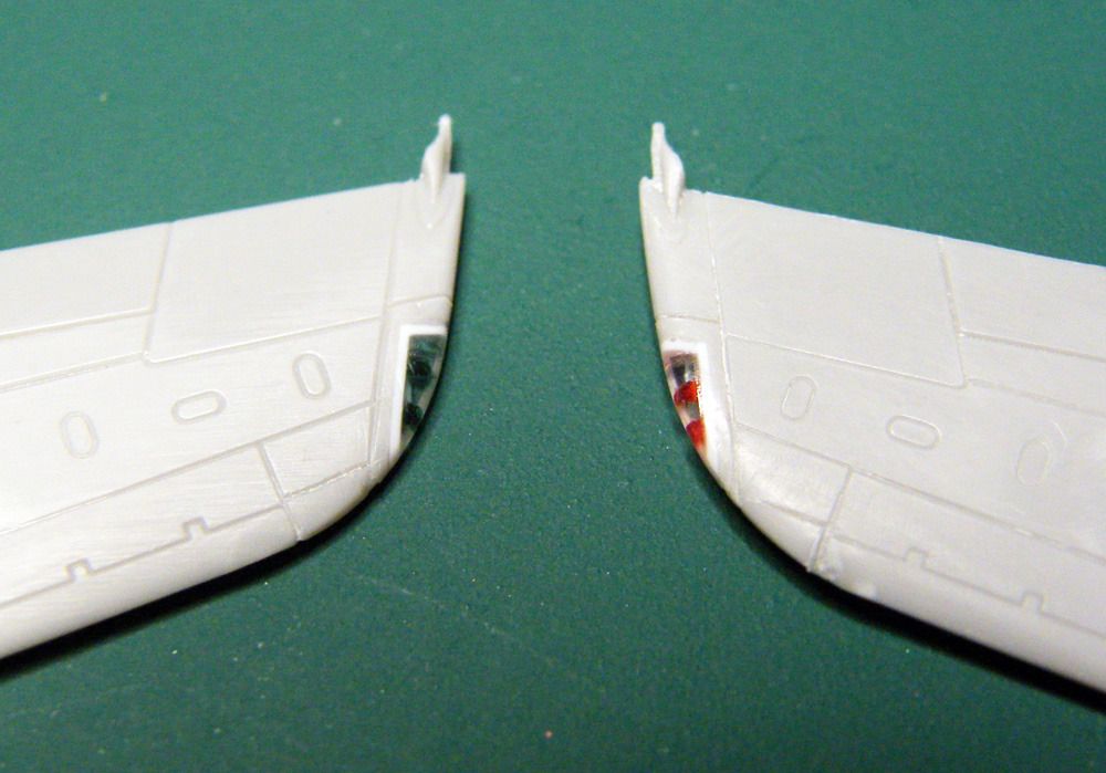

I did the usual on the wingtip lights. Added a shim of white plasticard to save me painting the inside of the lights. Two lights drilled in each bit of clear plastic then clear paint dropped in the holes. Sanded flush and polished. Bobs your uncle!

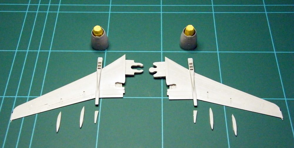

The wing components

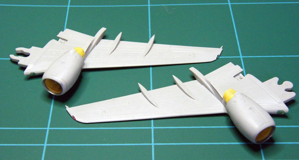

Wing subsection complete! [smilie=banana.gif] Painted areas already masked off to protect during the build process. It saves me doing them later when the parts are more awkward to handle and reach.

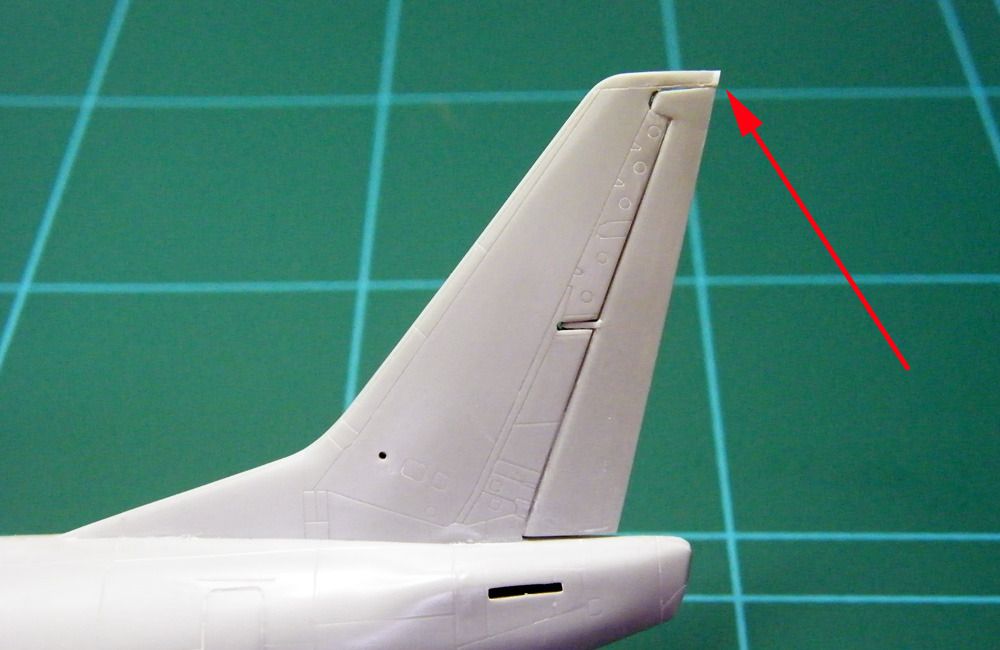

Rudder installed but I had to add a a very small thin bit of plastic to even up the edge (I probably cut it badly off the sprue). This was then sanded and blended in to an aerodynamic trailing edge.

love the landing lights Vinny really nice workmanship.

Yeah and the thin strip of plastic to replace sanded off bit is a great idea too!
