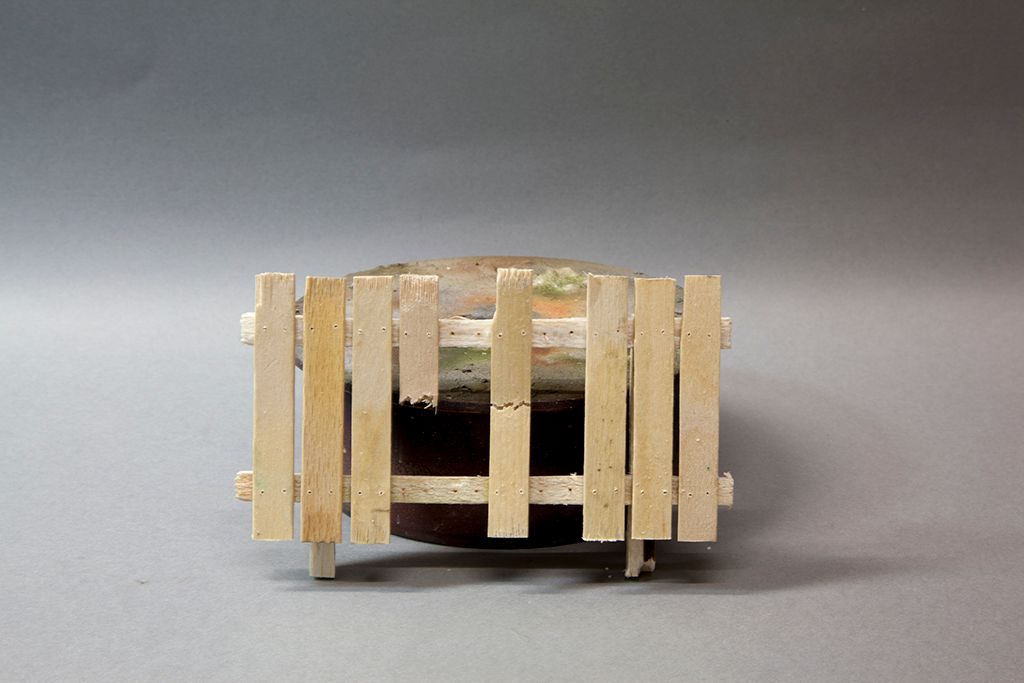

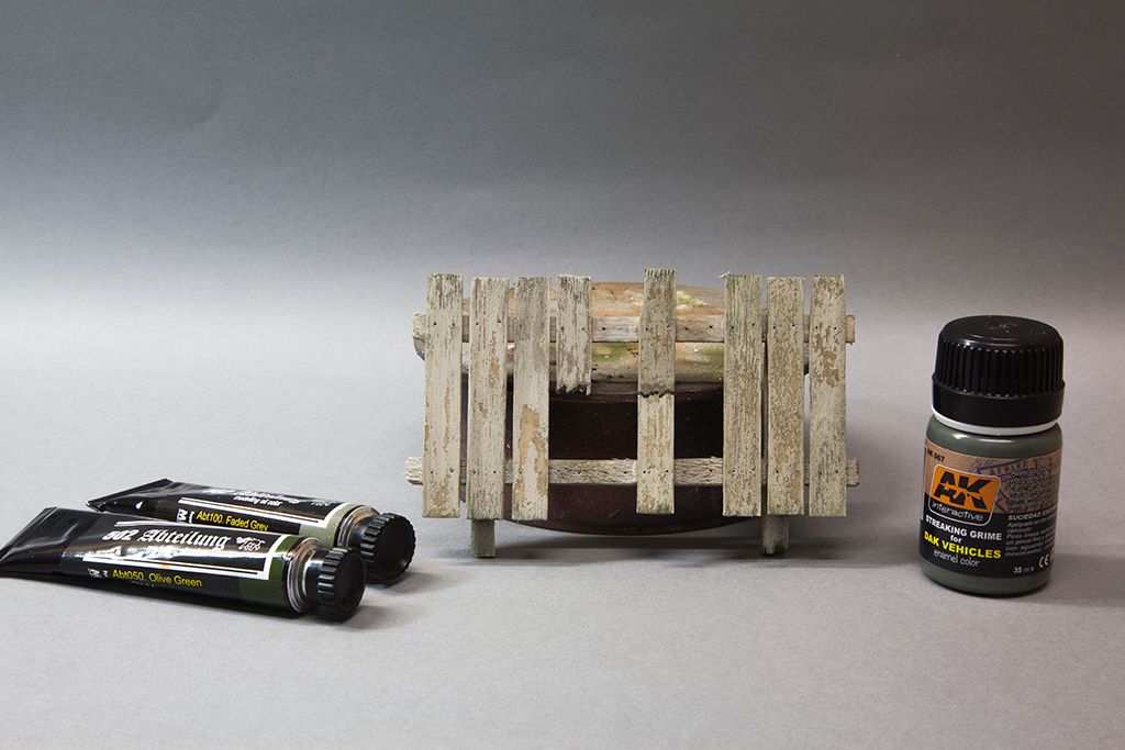

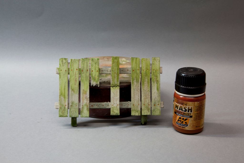

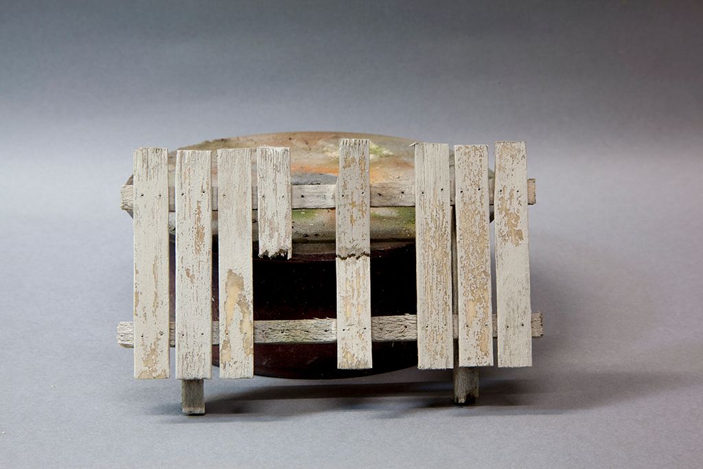

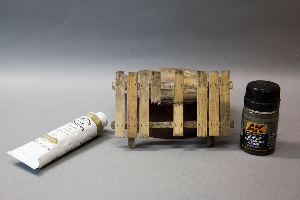

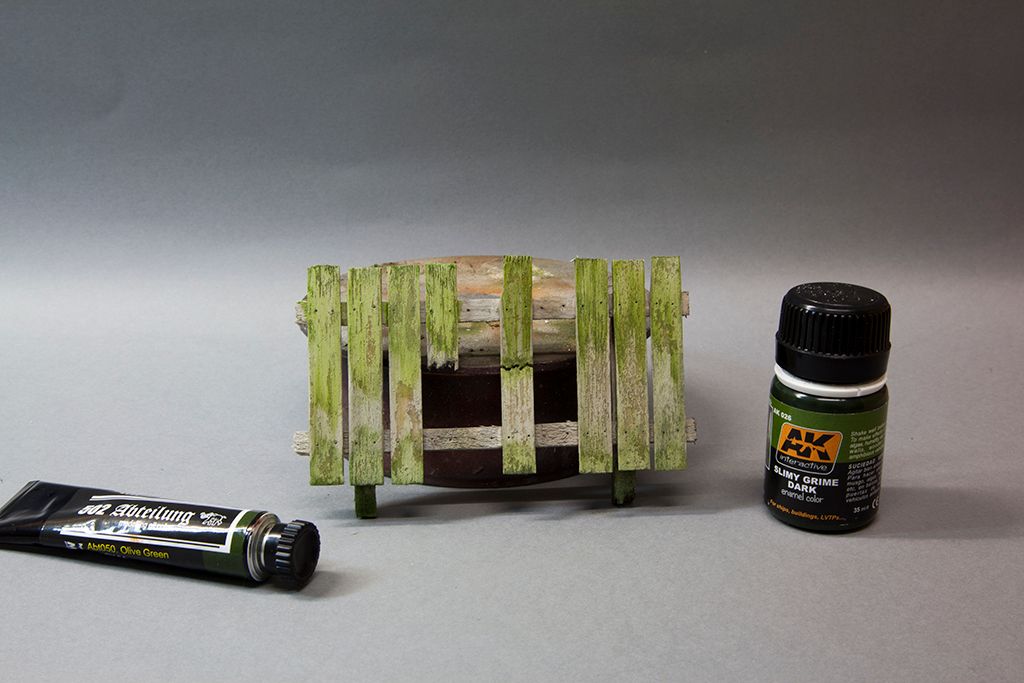

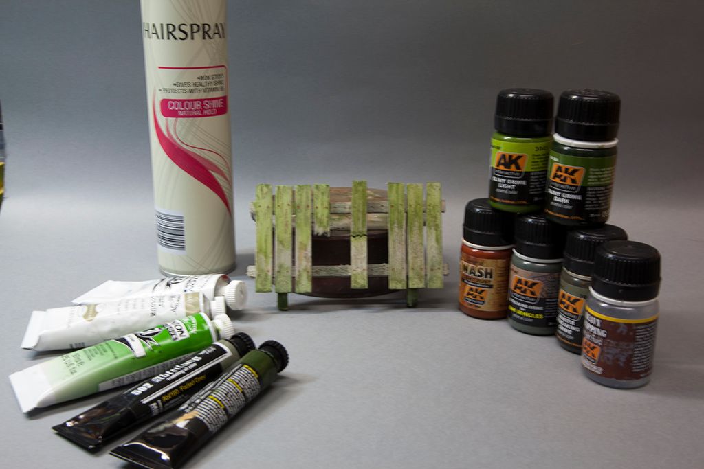

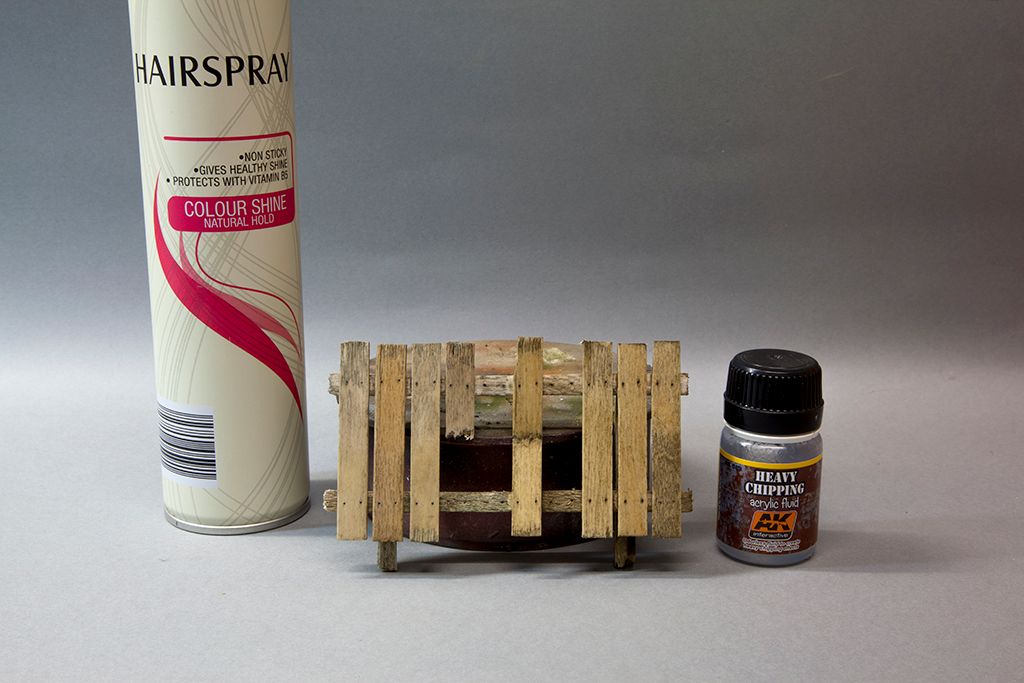

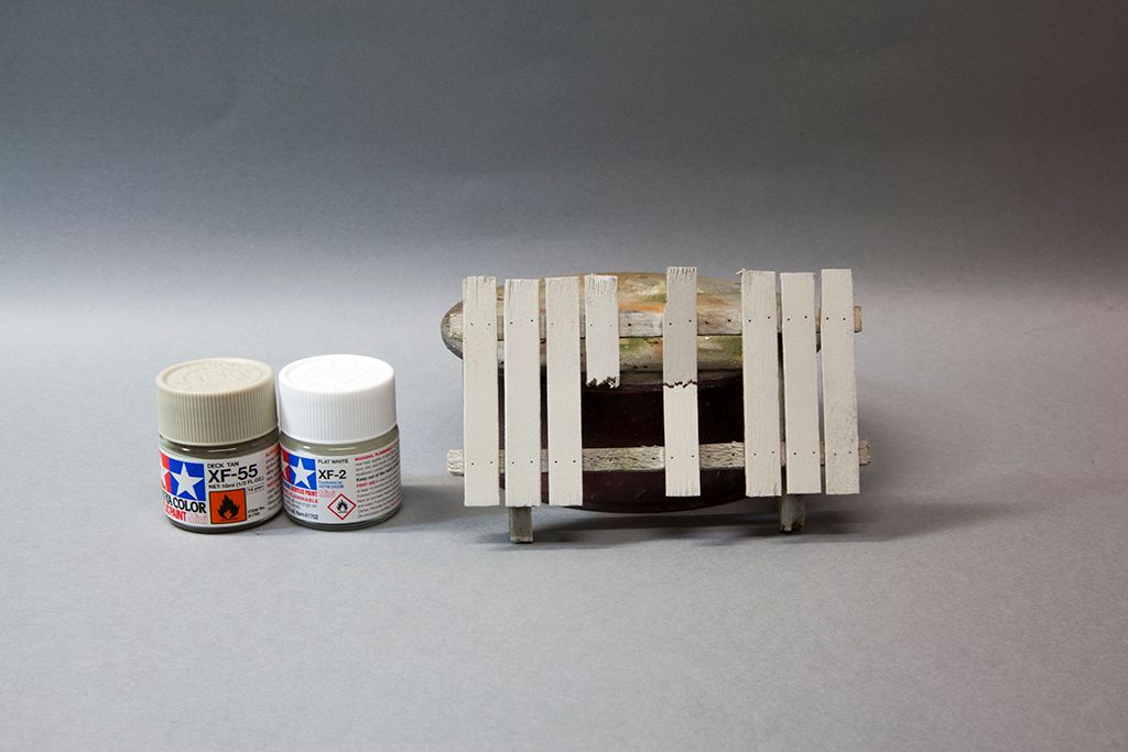

Try number two,
This is my piece i will demonstrate how to get an old dirty look to some wood, its just made from ice pop sticks and a bit of balsa
Oils on the Left AK on the Right
I start off by giving it a dirty Wash.
Next Seal it With a good coat of Klear/Future
Once Dry i used Hairspray one one half and AK Heavy chipping on the other
Once that was dry after about 20mins i painted both halves with Tamiya paint. I let that sit for about 15mins.
Next i used a selection of old stiff brushes. I soaked one half at a time and gently agitated the paint up and down until i started to see it wearing off,
Once that was dry with some help from the hairdryer i gave it another dirty wash with a different shade this time.
Next using the slimy colors i dabbed a bit across the top then using a clean Flat brush I dragged it down ward to get it to streak, i done the same with the oils
On the bottom i put less along the ends the using a clean brush again i stippled it this time.
Last was the rusty nails. (fuzzy pic) i dint use oils on the other half this time because i couldn't find my oil color for it.
And all i used, (again Fuzzy pic) Ak products are handier to use as they are ready made, some of the oil colors i needed to mix but no difference in how its done
Hope this is helpful to someone. ill be doing more at teh next meet. this one was just too long to show at that.
